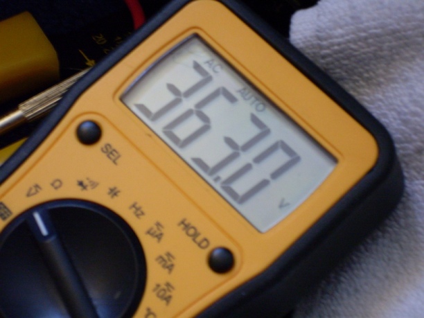

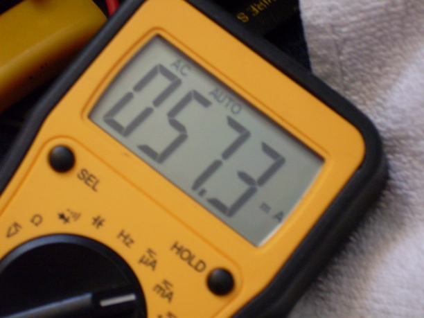

been doing some testing using my replication of the 8XA circuit...Im using a much bigger VIC bifilar coil than used in the 8XA setup. When I get resonance Im applying 30VDC pulsed at 2.4kHz to the VIC and measuring on just over 360VAC @ < 60mA across the cell.  The reason you get an AC voltage across the cell is due to the use of a LCL configuration. The LCL configuration will have a bidirectional current between the inductors and you will have a sinusoid waveform or AM waveform at resonance.  Because of the bidirectional current is why Stan used a blocking diode so to make the current go in one direction so that it doesn't short out the secondary of the transformer. Here are some of the waveforms scope shots Im getting at resonance.

Based on the XC and resonant frequency formulas I've come up with a value of 407mH for my chokes. so C=10.8nF, Fr=2.4kHz and Lt=407mH the resistance in the circuit is around 6143 ohms. So this is with in range based on my measurements, 363v / 6143 = 59mA.
