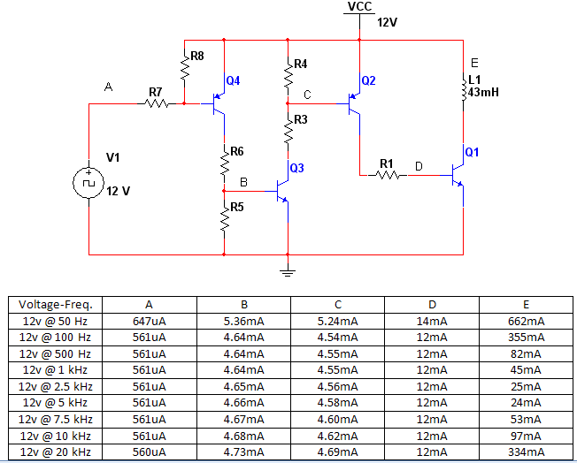

This is the DC analysis for the Driver Circuit with the 43mH Primary coil.

I also want to point this out, not sure if anybody has paid this much attention.

Yeah, I'm pretty sure those numbers are for the Injector VIC coil.
There's lots of good info in the appendix section of the TB.
Back to that injector VIC.....
Transformers are typically made so that no empty space exists (wire completly fills all the cavities/bobbins)
I calculated what the turns ratio would be if each cavity were completly filled.
Result: 400 turn primary, secondary coils (secondary + chokes) came up to 11,956 turns. (chokes completly filled cavities and turned out to 11.6K Ohms ea)
Turns ratio 1:29.89
12V input 358V out
Note that these calculations will not be exact in the real world, but they shoudl be fairly close.
I think the injector VIC used a lower frequency gate pulse to allow the voltage to build up higher (Up to 40kV)
Or this VIC operated as a flyback: Voltage comes from fast rate of current change from square wave
